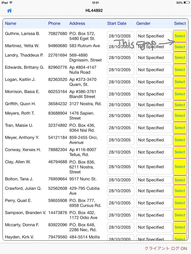

Is it possible to make buttons in the table without a gap between facecolor and border(please see the attached pic)?
I tried padding(0)/cellspacing(0) but nothing changed. Innerpadding doesn't seem to exist.

There are some properties that you could use to get this to look better.
Change the set up of your button to the following;
* Set up the button in column 6
#COM_OWNER.Set_Button Tablename('Table1') Tablecol_N(6) Buttonfacecolor(Yellow) Text('Select')
* Set the ButtonBorder properties for the button
#COM_OWNER.Set Property('Table1.COL%6.CONTENT.BUTTONBORDER.THICKNESS') To('1')
#COM_OWNER.Set Property('Table1.COL%6.CONTENT.BUTTONBORDER.COLOR') To('Red')
#COM_OWNER.Set Property('Table1.COL%6.CONTENT.BUTTONBORDER.CORNERRADIUS') To('5')
My tests show this removes the gap between the border and the Buttonface color,
I hope this works for you too,
Paul
Re: (RDMLX)Button in the table
Hi Paul,
Thank you for your advice.
It works!!
