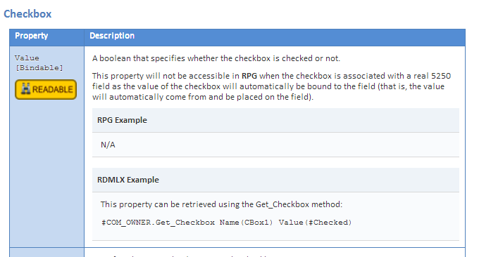

Re: (RDMLX) LRUSHOWPP : Show a popover message
You should only ever attempt to read (ie: get) properties that are marked as READABLE in the documentation.
Getting other properties would result in an undefined/unknown/unpredictable result and is not supported.
The READABLE marker against the property in the documentation indicates which properties you can reliably read/get.
