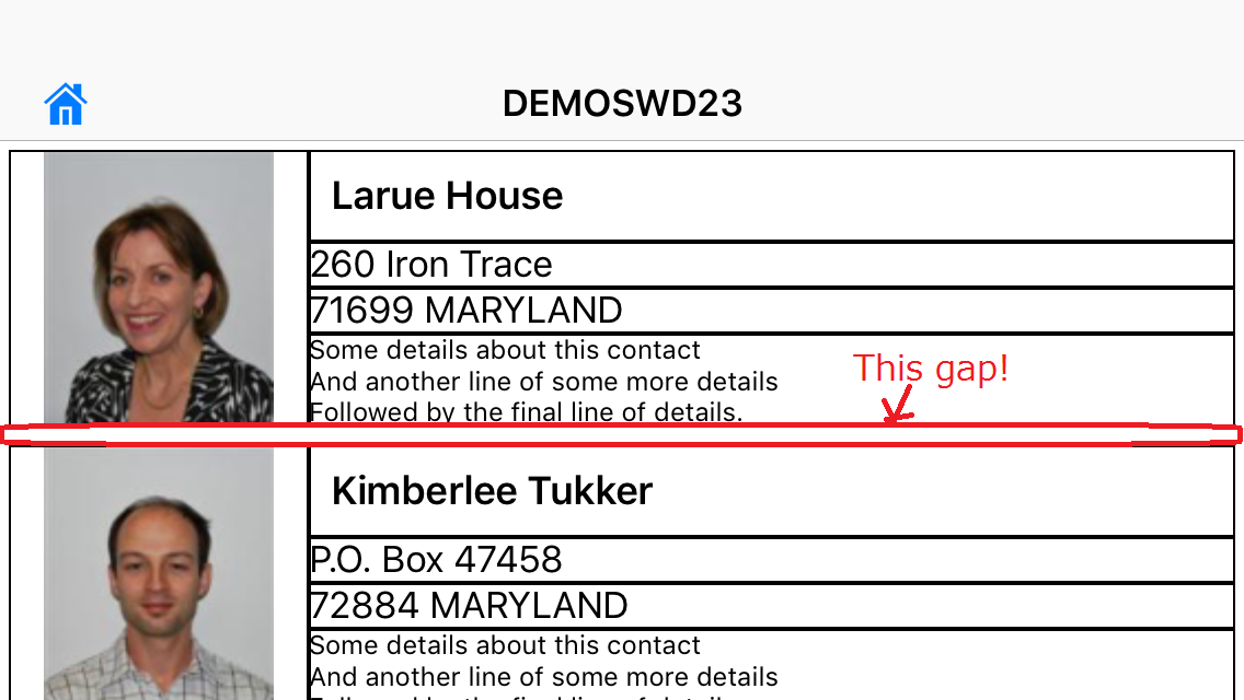

Is there any way to omit gap between subforms in table element?
I have tried to make multiple-lines table using subforms in table element.
I have used EXAM0077/D for sample.
However, there are some gaps between each subforms and I was not able to delete it...
Any advice would be appreciated!

Megumi,
Setting the 'CellPadding' property of the table to 0 should do the job.

Hi Tony,
Thank you! I got the expected result with CellPadding:0.
