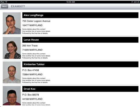

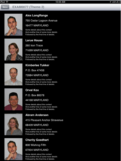

This example demonstrates
• How to create tables with rows that contain more complex multi-line layouts
• How simple code changes can radically alter the appearance of an App.
The example produces example screens like this:
See attached MS-Word document for all details.

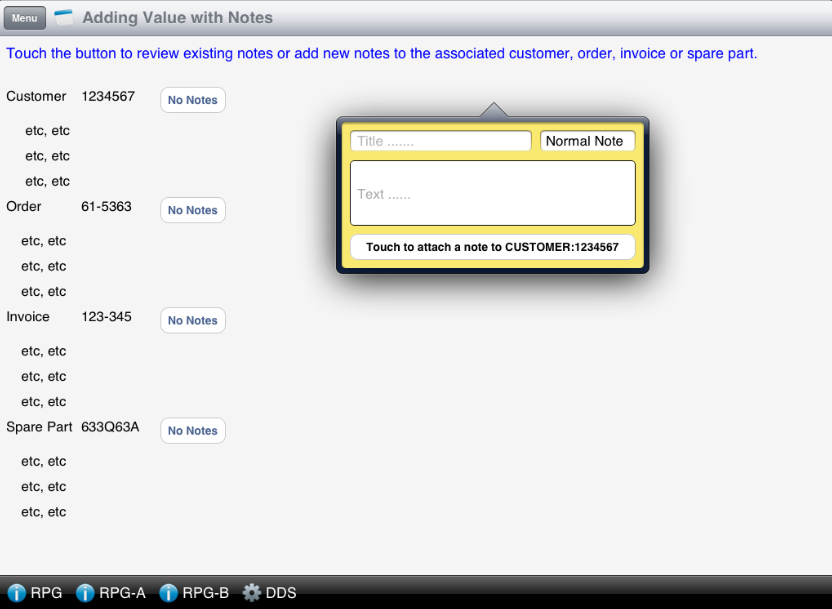

Look at Advanced Example -> Adding values with Notes.
Touch any of the “No Notes” buttons to create a note by using a generic pop over.
The yellow input popover is created by subroutine POSTNOTE_New_Note in program EXAM0068B.
It puts the input textboxes TITLE and TEXT onto the screen and creates a drop down named COLOR.
The “Touch to attach a note to xxxxxxxx” button is named SAVE has this logic ..........
LRNG_SetProperty('OnClick' : 'EXAM0068B_SAVE_NOTE');
LRNG_SetProperty('OnClick.Param%1':%trim(AssocContainer)); <====   Identifies this instance - the source or container element
LRNG_SetProperty('OnClick.Param%2':%trim(AssocNotesKey));  <===== Identifies data key (eg:Customer)
When you touch the SAVE button the subroutine POSTNOTE_Save_Note fires.
The values you typed into text boxes TITLE and TEXT and the selected COLOR are retrieved into RPG fields like this:
// Get the ‘container’ that owns the popover that is sending the request into RPG field AssocContainer .........
LRNG_GetProperty('/CurrentOp.Param%1' : AssocContainer : %size(AssocContainer) );
// Get the title and text
LRNG_Using(%trim(AssocContainer)+'.PopOver.Fields');
   LRNG_GetProperty('TITLE.Value' : NOTETITLE : %size(NOTETITLE) );
   LRNG_GetProperty('TEXT.Value'  : NOTETEXT  : %size(NOTETEXT) );
   LRNG_GetProperty('COLOR.Value' : NOTECOLOR : %size(NOTECOLOR) );
LRNG_EndUsing();
The main idea is that one of the parameters identifies the container/owner/source of the request.
If a table with input items was in the popover form you should be able to get their value(s) back into the program in much the same way.
